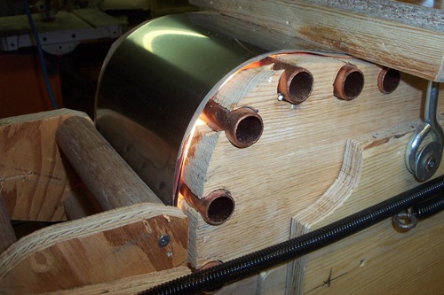

Charlie, believe me, John Hall is the solution here! unless you are ready to build a bender with at least 3-200 watts bulbs?

Charlie a fox bender with 3 x 200 watt bulbs will bend your wood just fine for starters. If you plan on doing cutaways -- a hot pipe is waiting for you in the plumbing section of Home Depot.

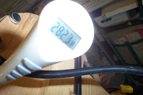

Serge -- I want your temperature gauge

[QUOTE=Anthony Z]
Serge -- I want your temperature gauge [/QUOTE]
Ain't it a cute one huh ?
Pwwecious gift from John Hall!
